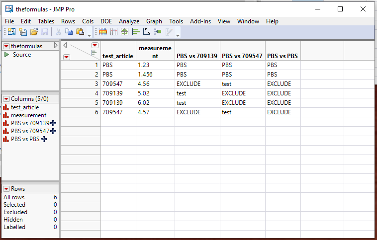

txnelson
Re: Create and populates new columns based categories in an existing column
The primary issue you are having is that within the definition of a formula, one can not have items that need to be evaluated.  JMP thinks everything within the formula definition is to be evaluated only when the formula is executed.
Therefore, the formula that is passed into the New Column definition, must be complete in it's syntax.  The modification of your code below works with your sample data table.
Names Default To Here( 1 );
dt = Current Data Table();
row = Associative Array( :test_article ) << Get Keys;
nc = N Items( row );
For( i = 1, i <= nc, i++,
	Eval(
		Parse(
			"New Column( \!"PBS vs " || row[i] ||
		Character,
		Nominal,
		Formula(
		if (Row() == 1, theTest = \!""
			 || row[i] ||
			If( :test_article == \!"PBS\!",
				zip=:test_article,
				If( :test_article == theTest,
					zip=\!"test\!",
					zip=\!"EXCLUDE\!"
			zip
Jim
Jeff_Perkinson
You need to get the value of row[i] into the formula. JMP doesn't evaluate expressions inside the Formula() part of the New Column() message.
You can use Substitute() to get the actual value of row[i] into the formula.
	Eval(
		Substitute(
				Expr(
					New Column( "PBS vs " || row[i],
						"Character",
						"Nominal",
						Formula( If( :test_article == "PBS" | :test_article == ri, :test_article, "EXCLUDE" ) )
			Expr( ri ), Eval( row[i] )
-Jeff

Sburel
Level IV
Works like a charm!
Thanks

Sburel
Level IV
Also works like a charm.
Thanks a lot
