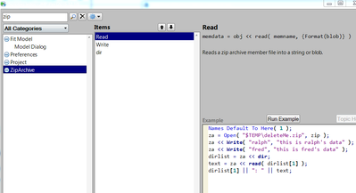

yes.  See ZipArchive in the scripting index.

Hi!  Sorry for the huge delay responding to this post.  I am finally back at this problem.  I really don't understand how to use these functions in the Zip Archive to unzip.
I have a directory of many folders which need to be unzipped (150).  The start of each folder name will be a device name followed by an underscore then the date (ie.  Device #150_2016_20_07.zip).  I would like to get the device name left of the underscore and make that a folder (done), and then extract all the contents to the new folder.  That's where my problem is and I am having troubles understanding how to follow that blog I posted above with JSL...
