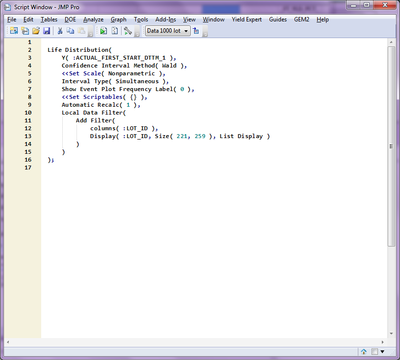

in tandem with the Syntax reference guide: JSL Syntax Reference
txnelson
Re: JMP 12 will not save Report. Expects scriptable Object error code.

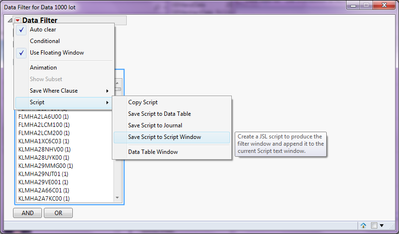

A Data Filter is applied to the data table, not to the platform.  What has to happen in the Life Distribution Platform, is that you need to turn the Automatic Recalc option on, so that when the platform detects a change in the data table(i.e. you changed something in the data filter), it will recalculate the platform display.
Once you have defined your Data Filter, you can request for it to give you the script that will recreate it.

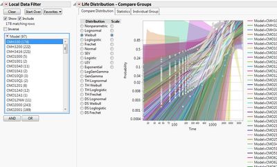

Now, you can also choose to use a Local Data Filter.
In that case, when you request for the platform to generate the script that will reproduce the Life Distribution you have setup, it will include the code for the local data filter
Jim

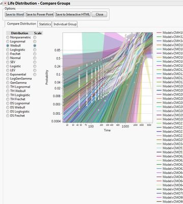

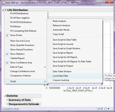

Two things happen when I attempt that.
(1) The Panel Box disappears
(2) The data filter doesn't make any visible changes to the plot.
(Image 1)
(Image 2)
In image one there isn't a data filter applied. When the data filter is applied(Image 2) the Save as options disappear. I was attempting to use the data filter to single out a specific model or group of models to display when selected. Are there any options that can provide me with more control using JMP 12? I understand that the version(JMP 12.2) I have may be limited.
Thank you for all of your help so far!
