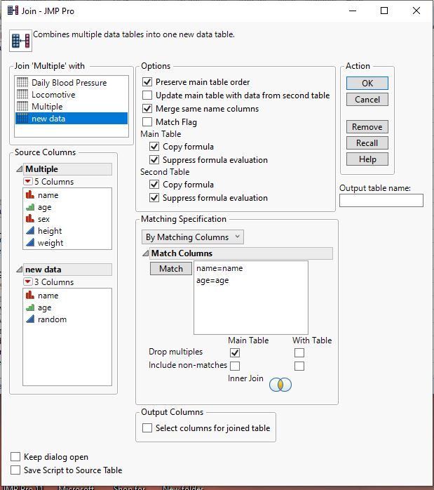

Under
     Tables=>Join
there is an option that allows for the elimination or inclusion of duplicates
Jim

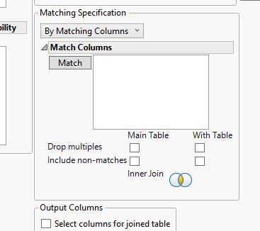

This is great, thanks! I am still struggling. I am trying to match up two data tables by their SITE ID, but whenever I choose table--join-- I end up with entirely too many rows. It basically multiplied each of the 15,000 rows by six, and I am not sure why. I've tried a different combination of conditions, but I am unsure of why it keeps duplicating. Instead of just simply filling in the missing duplicates I need at 15,000, it multiples everything. I keep ending up with 89,200 rows, or 102,000 rows.

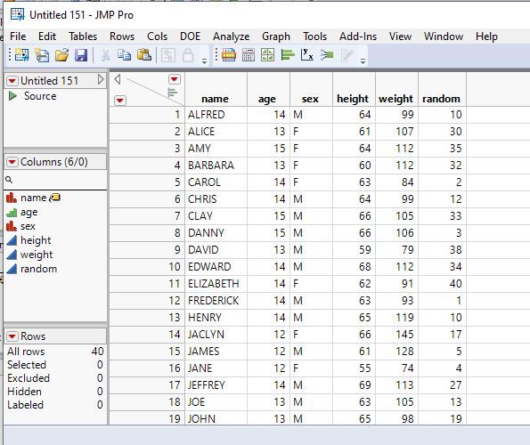

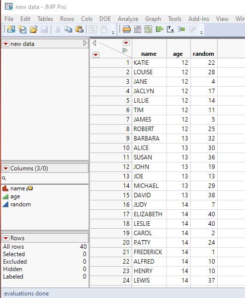

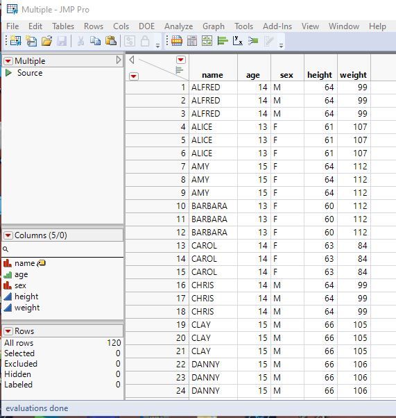

Here is a simple example.  I have 2 data tables, multiple and new data.
Multiple has 3 records for each name/age combination.  A total of 120 rows of data
New Data table has only 40 rows of data
If you join the tables using the below settings
You end up with a joined table with only 1 copy of Name/Age values
Jim

  Yes, it definitely sounds like what you really need to do is join the tables and to use a specified column as the matching column. @txnelson gave a great example of how this is done. Depending on exactly how the tables are to be joined, you'll need to check certain boxes for different kinds of joins: inner, outer, full, or remove duplicate rows, etc. The join command is powerful, but it helps to know how all the options change the kind of join that JMP does. You can read more and see another example here.
