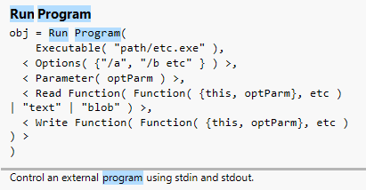

txnelson
Re: Can JMP launch an excel.xlsm file?
See the function
in the Scripting Index
Jim
