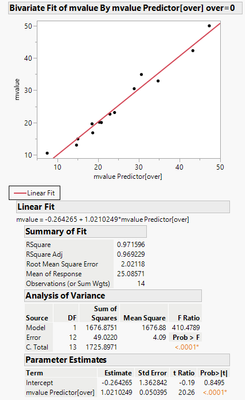

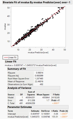

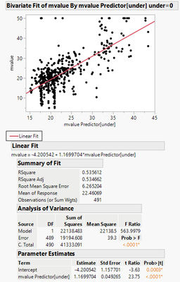

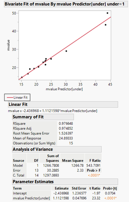

  I tried the second approach with the Boston Housing.jmp sample data and it turned out pretty well. It did not quite overfit the data to give me a larger R^2 on the "validation" data of the oversampling data set, but it was larger than using a validation column and fitting the data using that.
  By the way, I fit the data using the XGBoost platform and (response = mvalue; all other columns are X, Factors) used the default settings with the Autotune box checked.
undersampling results (1= training, 0 = validation):
oversampling (1=training, 0=validation):

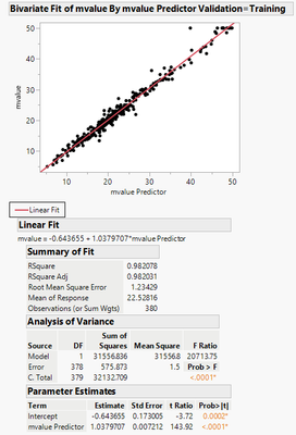

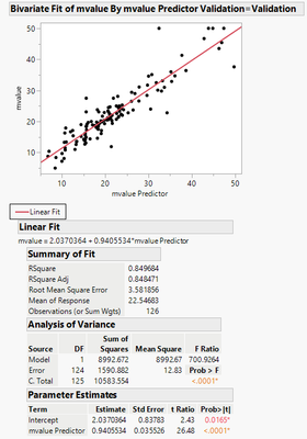

Here's the results using a .75/.25 training/validation column that was stratified on mvalue:
The R^2 of the last validation data is not as high as the oversampling model, but it's likely more accurate since more samples were used in the validation of the model than when taking too many samples to train.
