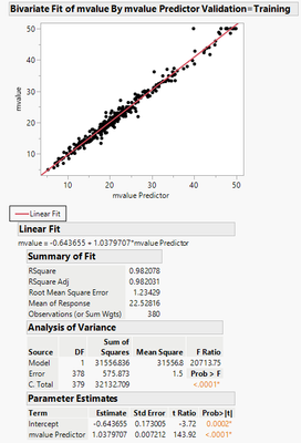

  One option would be to create a validation column where you have it highly offset to one variable, say 10% training and 90% validation, then you make a subset of the training data and do your fit on that. Save the fit formula to the subset table and then bring it back to the original data table and see how well the fit works on the untrained data. You can then do the reverse by treating the validation data as the "training" data, repeat the above steps and see how well it fits the training ("validation") data set. You might do this option if you want to stratify your validation column based on the output you're modeling, however, if you don't care, then you can try the other option.

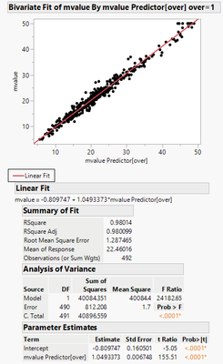

  Another option is to use the Row > Row Selection > Select Randomly and use either 10% or 90% -- or even 1% and 99% and then make a subset of each of those and do the fits and bring the formulas back in to compare how they do with the unused data from the original table.

  I tried the second approach with the Boston Housing.jmp sample data and it turned out pretty well. It did not quite overfit the data to give me a larger R^2 on the "validation" data of the oversampling data set, but it was larger than using a validation column and fitting the data using that.

undersampling results (1= training, 0 = validation):
oversampling (1=training, 0=validation):
SDF1_2-1705078260114.pngSDF1_2-1705078260114.pngSDF1_3-1705078269380.pngSDF1_3-1705078269380.png
