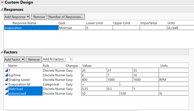

I would like to study an impact of the six factors on evaporation (at the end I would like to have a “rigorous” model with possible interaction effects and power terms):
I already know that the first four have a strong impact on evaporation and would like to know whether the last two (plate load, volume/well) should also be included in the study (model).
How do you suggest to to set up an experiment? Would it be most efficient to first find out whether the two factors (plate load, volume/well) are significant (how to set up a DOE for this purpose?) and then proceed with DOE (augmented DOE?) to get more accurate information about the factors and their (possible) interactions?

First question I have is do you really want the Role of all but one of the factors as discrete numeric?
gam1
Level II
Re: Significance of few factors among several
No, it is not mandatory. The factors could also be treated as continuous numeric.

I didn't do any measurements yet. Firstly, I would like to identify whether the plate load and the volume/well are significant factors. Secondly, and this is the main goal of the study, I would like to have a prediction model for the evaporation (rate). The evaporation is unwanted side effect that I would like to reduce.

I'm generally a fan of sequential problem solving using DOE. Start small. Learn as you go. Make future decisions based on incorporating new knowledge and information. So starting with a simple 2^2 full factorial in plate load (note I'm recommending only 2 levels for plate load, you don't need 3 to assess significance) and volume/well should give you an idea of their impact. Then depending on how that turns out, plan a second experiment based on what you learn. Too many divergent pathways to give you a single recommendation. Keep in mind noises as you go along in time. Blocking is your friend.

I like the idea of "starting small" :) But on the other hand I share the statman's concern:
"The smaller the inference space, the less likely the results will hold true in the future (when this conditions invariably change).  If you only experiment on 2 factors, what are the other factors "doing" during this experiment (e.g., are they changing?, are they constant?)."
I guess that in case if there is no significant impact of plate load and volume/well after conducting the 2^2 factorial there is still quite significant chance that the 2 factors still have an impact at some different combination of the 4 (significant) factor that were held constant at the 2^2 factorial experiments.

In my 2^2 full factorial recommendation, I was reacting to your comment, '...firstly...'. I have no quarrel or issue with designing a larger experiment if you feel there is '...still a quite significant chance that the 2 factors still have an impact at some different combination of the 4...'. You've just described in words a desire to estimate interaction effects among the full process space. So building an optimal design that specifically provides estimation of desired interaction effects is the way to go.

"I already know that the first four have a strong impact on evaporation and would like to know whether the last two (plate load, volume/well) should also be included in the study (model)."  How did you study the first 4 factors (e.g., observation, experimentation)?.  What levels were plate load and volume at when those 4 were studied?  If they were constant, the effects of the 4 factors you studied are contingent on those levels (they are part of the inference space).  If they varied, they would contribute to the experimental error.  Realize the design space and inference space will impact how useful the experiment will be for prediction.

I'm not sure I understand your level setting.  Analysis is easier if the levels are balanced and equidistant (e.g., T at 20, 27, 34; ExpTime at 4, 7, 10)

I know that the first 4 factors impact evaporation from observation. This is also in agreement with my knowledge of chemistry/physics. I have  a "feeling" that the last 2 factors might also have and impact on evaporation. I would like to confirm/reject this by conducting experiments/measurements. I assume that these measurements can be also used later in DOE (the aim of this DOE would be construction of a prediction model).
