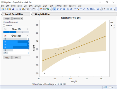

Names Default To Here(1);
gb = dt << Graph Builder(
	Size(525, 454),
	Show Control Panel(0),
	Variables(X(:weight), Y(:height), Overlay(:sex)),
	Elements(Points(X, Y, Legend(9)), Line Of Fit(X, Y, Legend(11))),
	Local Data Filter(
		Conditional,
		Add Filter(
			columns(:sex, :age),
			Where(:sex == "F"),
			Where(:age == {13, 14, 15}),
			Display(:age, N Items(6))
-Jarmo

Still not really knowing what you are doing, so I would still suggest using data filters, but maybe data filter instead of local data filter
df = dt << Data Filter(
	Conditional,
	Add Filter(
		Where(:sex == "F"),
You could also build customized UI but how to build it, depends a lot on your data and what it is used for.
