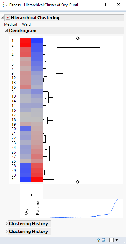

I just took another data set in the Samples folder, Fitness, and performed a two-way clustering using only default settings and changing nothing:
My guess is that you have some column properties or row states for color that are interfering with the default coloring.

Thank you for reply, you are right and as indicated by Jim I had to change column properties.
