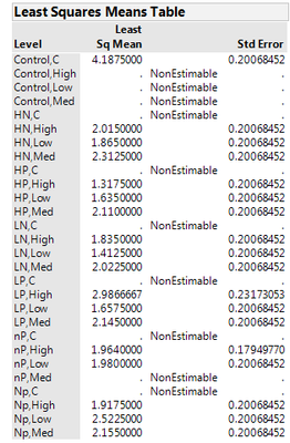

I can paste this table because it doesn't reveal what I'm studying:
11805_Interaction Least Squares 2-way ANOVA.png11805_Interaction Least Squares 2-way ANOVA.png
By the way, 'C' is also 'Control' - I thought that it would help if I changed one of them. This is the interaction table - similar results for Effects A and B, i.e. Control interactions are 'NonEstimable'. Thanks. -LH
