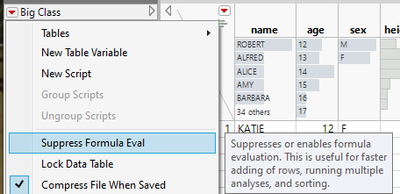

suppress Formula Eval(1) [without a data table] is great to trick colleagues - no chance to notice - JMP is stuck and no chance to fight against it, neither via the GUI:
nor via   dt << Suppress Formula Eval( 0 );

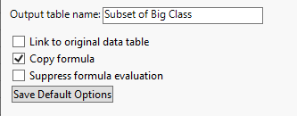

Some Table operations like Join have a setting to suppress formula evaluations:

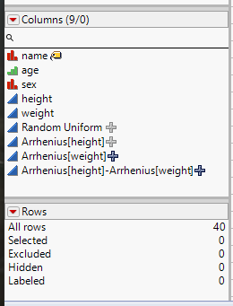

fun fact:
the status in the columns menu doesn't get updated automatically, so don't get confused by the gray plus sign:

There is also difference between << Suppress Formula Eval() and Suppress Eval(). << Suppress Formula Eval() is for data tables and Suppress Eval for formula columns
If you have Suppress Eval enabled, you can loop over your columns (use << get column names and for each) and send << Suppress Eval(0) to all your columns. I'm not sure if there is any "easy" way to do this interactively (Standardize Attributes won't work as it will replace all your formulas), subset can be used but it will create a new table which might not be ideal.
But if you don't mind creating new datatable subset is fairly easy option
