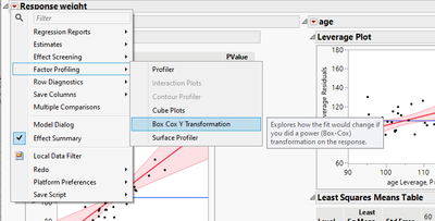

Hey @StacyKJones, I second what @txnelson suggested with the Box Cox option being located here:
Not only will this find the best transformation, you can refit the model as a new analysis window so you can compare both models to see how the transformation improved it.  Also, it keeps the units in the original units for profiler which is nice.
