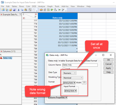

To demonstrate the issue, run this code to create a table with some dates in m/d/y format, and then set that column to use d/m/y format, as shown in the screenshot below.

Now set all values at once in column info and note how some data is set to missing, even after changing the column back to character.

The resulting missing values from Char to Num is due to the Input Format.
Missing results start around row 113 with this "02/13/2021 12:23:50 AM". "d/m/y h:m" Input Format interprets it as the 13th month, which is invalid.
When there is a mistake in conversion, changing format back won't cut it, because the underlying values have been changed. The missing values no longer hold a valid time value. Use "Undo" under Edit instead.
