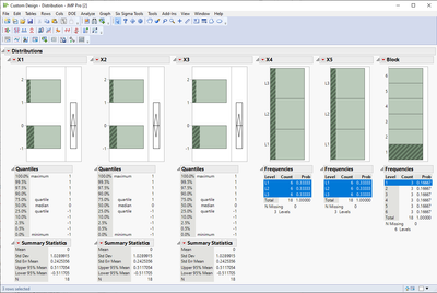

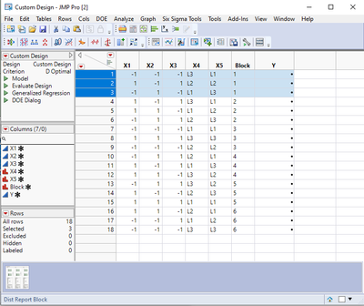

  I am sure there is a way to do this, but I think more information is needed. Can you provide some more details without revealing any specifics of your situation? You can keep the factors as X1 and settings as -1 to 1 or the categoricals as L1, L2, etc. Also, without knowing what the actual constraints are -- are they on the continuous variables or on categorical? This would change how you include them as linear constraints or as disallowed combinations.
  Using the Custom Design DOE platform would be the best option, I think. Without knowing what the constraints are and just mocking something up based on what I understand from your description, the below is a design with 3 continuous factors X1, X2, X3, two 3-level categorical factors X4, X5 with levels L1, L2, L3, and a Blocking factor. Each Block will have three runs with each level of X4 and X5 being represented, as well as the appropriate combinations of low and high levels of the continuous factors.
  From your description, this sounds somewhat like what you're after. Again, there's no constraints on the system right now since that was not defined.
  Does this help, or is it not what you're after? If you can provide more details, that could help get you in the right direction.
