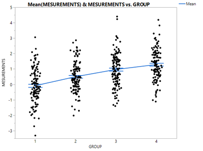

Hi JMP Community,
I would like to know if it is possible to evaluate(in JMP 13.1) trends in a data where X is ordinal (4 Groups) and Y is continuous (see attached file).
Based on a visual inspection, it appears that the means of Measurements are progressively higher with each group but I have not been able to find a method to evaluate this formally.
Thank you for your help.

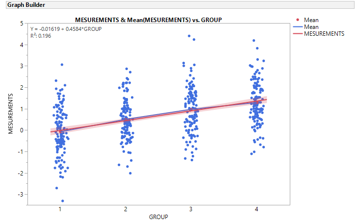

@Thierry_S, in JMP 13 Graph Builder, you can add a Line of Fit via  the UI or use this saved script
Graph Builder(
	Variables( X( :GROUP ), Y( :MESUREMENTS ) ),
	Elements(
		Points( X, Y, Legend( 3 ) ),
		Points( X, Y, Legend( 4 ), Summary Statistic( "Mean" ) ),
		Line( X, Y, Legend( 5 ) ),
		Line Of Fit( X, Y, Legend( 6 ), R²( 1 ), Equation( 1 ) )
	SendToReport( Dispatch( {"Line Of Fit"}, "", OutlineBox, {Close( 0 )} ) )
Here is the result.

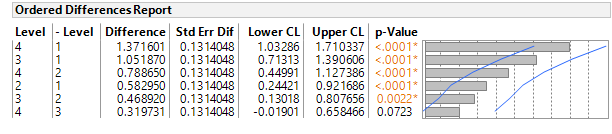

  • Use Analyze > Fit Y by X to run a one way ANOVA, the means should increase with Group and you should test for global significance difference in the means then compare the groups.  For example, does Group 3 have a statistically different mean that Group 4, etc.
  • Look at the successive differences in the group means ( 2-1, 3-2, 4-3), they are are all positive (0.58, 0.47, 0.32). 4-3 is not significant at 0.05, however, the p-value is 0.07 which provides some indication of a trend, but maybe slowing.

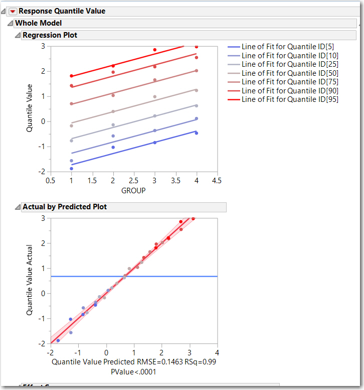

However, when looking for a shift in the "distribution" of these groups, I like to take a different approach:
  • From your table, compute the distribution quantiles for each Group, 95, 90, 75, 50, 25, 10, 5 using Tables > Summary. The resulting table needs a little work: stack the quantiles, simplify the Quantile ID.
  • Then I like to look at the relationship of the 90th percentile (for example) across the groups. Is it changing as much of as the mean?
  • The summary QuantizedTable and the script to create the analysis below is attached to the table. This graphic indicates that the entire distribution is shifting, not just the mean... which lends strength to the argument of a trend by group
Let me reiterate, this is an exploratory analysis. Any modeling or further investigation should be placed on the drivers/cause of the shift.
