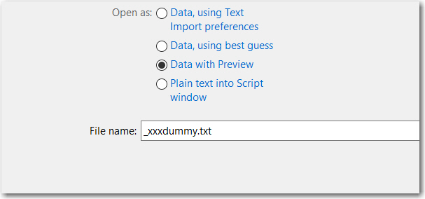

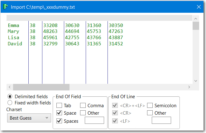

@emmablue, Jim provided a solution of how to fix the problem once the text file is imported. I will explain two options, each depends upon your original file.
#1 If your original file has spaces as the column delimiters, the fix could be easy. When you select File >Open use the option Data with Preview and make sure both Space and Spaces are selected
If you had selected Data, using Text Import Preferences, your default could be Space. If that is the case, the fix via the UI is use Data with Preview. If you are using a script, the Open statement in the script below should be used.
