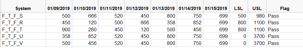

Hi,
I have a problem with the script.
I get an empty column when I try to use the loop.
When I don't use a loop, it's works.
col = dt << get column names;
For(i = 1, i <= N Items(col), i++,
    c = "c" || Char(i);
    Eval(Parse(Eval Insert("^c^= column(dt,i)<<get values"))));
New Column( "Flag",
Character,
Nominal,
Formula(for(i=1,i<3,i++,
if(c2[i]>:LSL[i],"Pass","Failed"))));

Botzal
Level III
Re: Formula Loop - variable columns
Thx for your answer.
* According to your script, it's not working so well  - I get the same answer every row, because you are printing after the loop.
* As for the big issue -
 What do you propose to do?
 I need to check that every row(to all columns) between the LSL and USL - But the problem is, the name of the columns changes all the time.

Botzal
Level III
Great,
Thx for your support.
Next time I will provide full details and solutions I have already tried.
