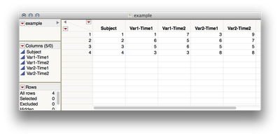

You can do this with a "multiple series stack." For instance, in the example dataset below I have 4 subjects measured on two "series" -- variable 1 and variable 2 -- each measured at two time-points.

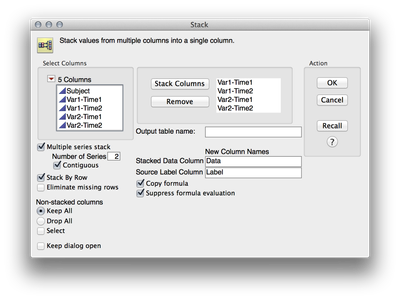

If I want to stack these data such that I have 8 rows, 2 for each subject, with separate columns for variable 1 and variable 2, we can check the box in Tables > Stack for "Multiple Series Stack." In this case, we have 2 series, and the columns are contiguous; that is, the multiple observations for each variable are next to each other, rather than interleaved (e.g. we don't have the columns like this: Var1-Time1, Var2-Time1, Var1-Time2, Var2-Time2).
Here is the set up for Tables > Stack.

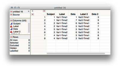

And here is the dataset this will produce:
To clean things up, I would rename "Data" to be "Var 1", and "Data 2" to be "Var 2." Then, I would select the "Label" column, and invoke Cols > Recode, and recode each level to be either Time 1 or Time 2, so you will have a variable identifying the time points. "Label 2" is redundant and can be deleted.
