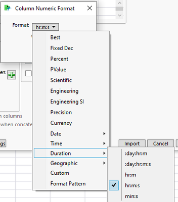

jthi
Re: Time Format Excel to JMP
I'm not sure if this will work, but when you are exporting the data to JMP with Excel Wizard, right click on the column which has wrong format. This should allow you to change the format, hopefully this will work
If this won't work, could you export the dates and then calculate difference in JMP?
-Jarmo
