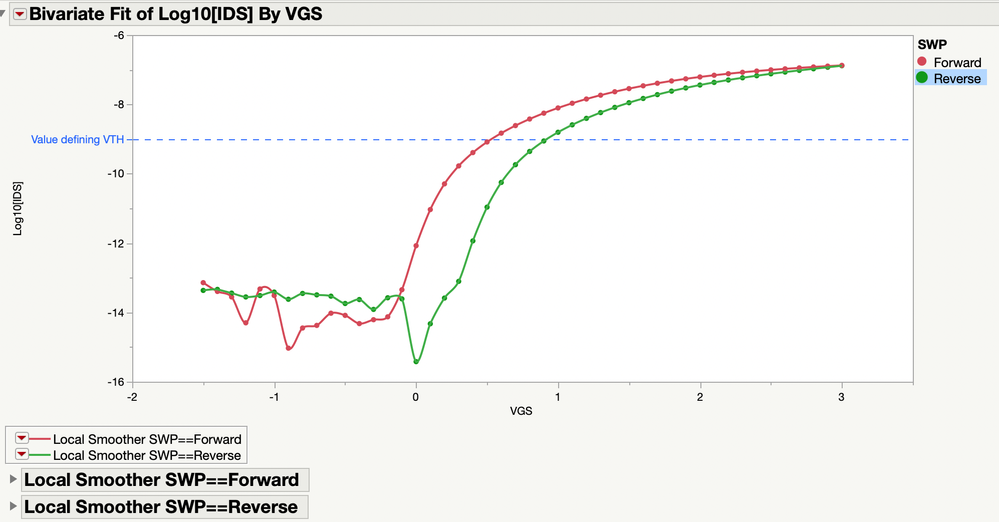

It's been a while since I thought about such things. I took a quick look at your data. In connection with the plot below, can you explain further how you would want to combine the results from the forward and reverse sweep to get one VTH value for each combination, please?

Having looked at a few other combinations, I know that their data is not always so nice. Is the '-9' value you mention universal?

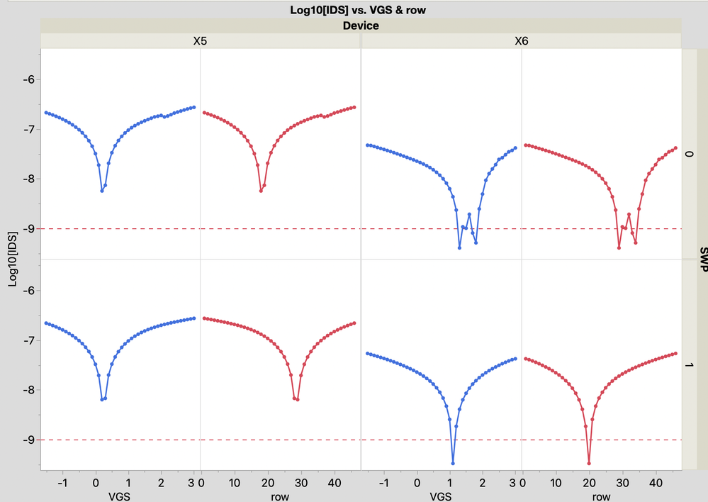

Based on the graph below, it does not appear that it is always possible to find consecutive values of log10[IDS] straddling -9, (x5), so you'd have to decide how you'd like to report that. Also, in cases where log10[IDS] does cross -9, (x6) the closest values above and below -9 may not fall on consecutive rows, so care must be taken to define what you want there, as well.

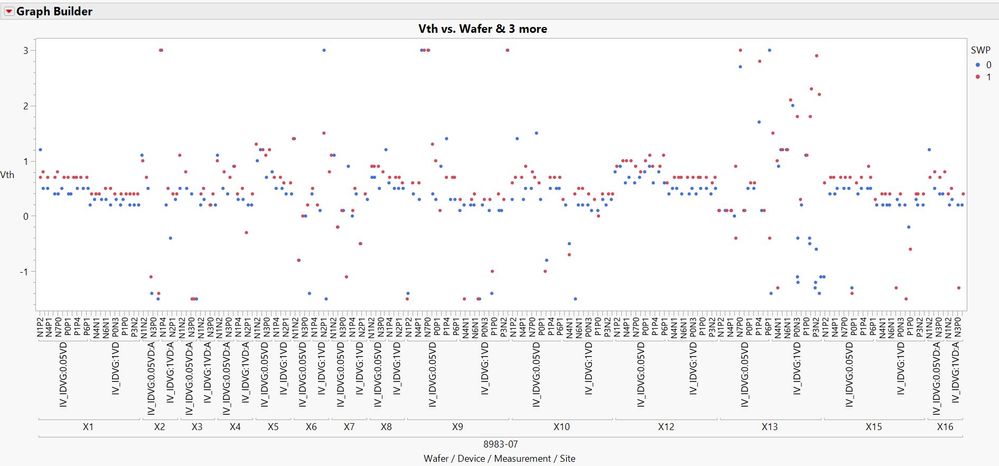

I also plotted Vth values on Wafer 8983-07, partition by Wafer / Device / Measurement / Site, and overlay by SWP. Is this something you looking for? Vth value for each of the unique combinations?
