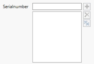

Hello,
I would like to provide a list of parameters or variables from the window level (for example copied from excel) and pass this list (for example by clicking OK) further to create an another list for a SQL query. Can I do that with some type of List Box (something like in the picture below)? What other methods could be used to do that? Best regards.

lukasz
Level IV
Re: How to enter and pass data from List Box?
Hello,
thank you for suggestions. I would like to be able to copy serial numbers from somewhere and then pass them further using parsing function, so the option 2 and together with modal window. I will try with Text Edit Box.
Best regards
