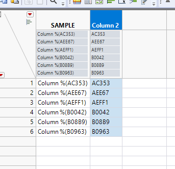

I have this column SAMPLE where I need only to retain the code inside the () but somehow, I cannot remove the Column% word and the parenthesis. I tried using Word(2,:SAMPLE) but it only returned an error.
How to remove the word Column % and the parenthesis from the string?

Attached file is the sample data table. What I want is that only AC353, AEE67 and so on would be the only values of the column sample.

Formula I provided with "()" should work, just replace :S with correct column
