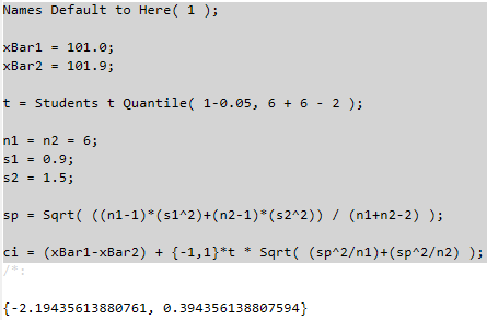

I used this JMP script with the correct formula:
Names Default to Here( 1 );
xBar1 = 101.0;
xBar2 = 101.9;
t = Students t Quantile( 1-0.05/2, 6 + 6 - 2 );
n1 = n2 = 6;
s1 = 0.9;
s2 = 1.5;
sp = Sqrt( ((n1-1)*(s1^2)+(n2-1)*(s2^2)) / (n1+n2-2) );
ci = (xBar1-xBar2) + {-1,1}*t * Sqrt( (sp^2/n1)+(sp^2/n2) );
I get the result [-2.49120941403157, 0.691209414031555], which exceeds the stated equivalence interval of [-1,2].
JMP uses the second method you illustrate. JMP calculates from the data, not summary sample statistics, so I can't verify the conclusion by the second method.

Hi @Mark_Bailey : Your t needs to be adjusted.
Should be
t = Students t Quantile( 1-0.05, 6 + 6 - 2 );
This is because, for equivalence at alpha=0.05,the 90% CI (1-2alpha CI)  confidence interval is evaluated.
Re: Test d'équivalence de moyennes (TOST / Schuirmann) - sujet statistique
Good catch! Amended script and new result.
MRB3855
