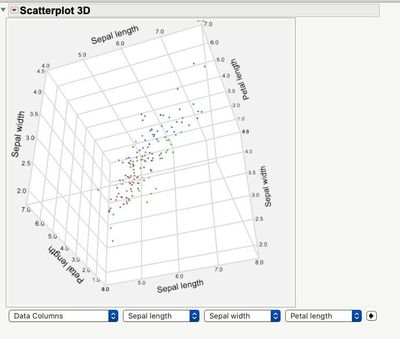

I'd be happy to test, but don't know what is to be expected.  Here is a png of the output of the Iris data table
Seems to load just fine and runs fine.  Tested on
1. Catalina JMP 16.2

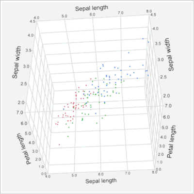

There are animations on this article 3D Plot Tools showing the expected output of the first item, and an animation showing how the second item should behave.

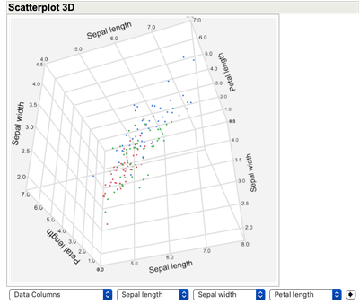

Sorry, I might not know exactly what to expect, but when I select the make .gif button on the sample data with the same options as yours, On the Mac running Catalina (10.15.7) JMP V 16.2 all I get is a picture:
As far as scrolling, I can move by axis or rotate freely moving my mouse in the cube.
Here is what the output looks like:

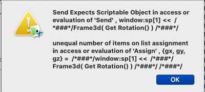

Just running the Iris data table I get the following error:

Thank you @statman, I think I can work out where that is happening..
