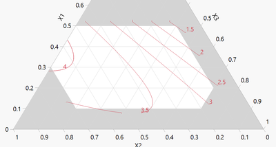

You need to have a formula column with a model that describes the "tie lines" or contours, as they would be called in JMP. See the attached example.
Graph > Mixture Profiler. Add your formula column in Y, Prediction Formula and click ok. Then look in the Mixture Profiler red triangle menu for the various options to define the contours and other aspects of the appearance.
