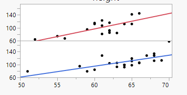

In JMP 15 it was easy to modify the frame size of the fits in the fit curve platform using a group variable.
In JMP 17 it seems to be different. Even if I modify the frame sizes manually and I try to get the appropriate script by using "Save By-Group Script to Script Window" I don't get a script with modified frame sizes.

My question is how to modify the frame size of the linear fits:

I would use XPath to get the reference to all Frameboxes and then pick from those all I want to modify. Below is example where the size of all frameboxes is modified
Names Default To Here(1);
obj = dt << Fit Curve(Y(:weight), X(:height), Group(:sex), Fit Linear);
fbs = Report(obj) << XPath("//FrameBox");
wait(1); // for demo purposes
fbs << Frame Size(316, 134);

I'm just wondering why it's not possible to manually resize the window to generate a script that does the same thing.
jthi
Re: How to script frame size of fits in fit curve platform with group variable
Quickly checking it seems like JMP isn't able to capture the modifications done to the FrameBoxes which are within Linear outlinebox.
