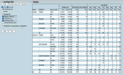

Hi,
The task is preparing everyday the daily sales of actual day.
Task is first completed by Tabulate (because of aggregate statistics) and then taken into Data Table and later updated with other data tables...etc...
Tabulate has local data filter but when scripting it to data table the local data filter does not take effect.
Any ideas, JSL mistakes, solutions?
Many thanks in advance

This appears to be a timing issue of some kind.
These are now rare in my experience, but when they do occur inserting a 'Wait(0)' generally fixes things. But, in this case, to force 'make Into Data Table' to respect the current report state (as defined by the Local Data Filter), I had to insert a short, but non-zero, delay:
