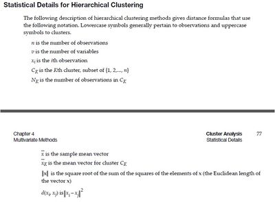

This is taken from the Multivariate Methods book available in JMP under Help==>Books==>Multivariate Methods11050_Documentation on Distance.jpg11050_Documentation on Distance.jpg
Jim

Thanks, Jim. It looks like that the distance is calculated as the Euclidean length between two vectors. Then which two vectors are used to calculate the "Distance"? Is it the distance between each row and the center of the cluster of that row? Or is it the distance between each row and the mean of all rows? However, rrom my calculation, the "Distance" is larger than both cases.
