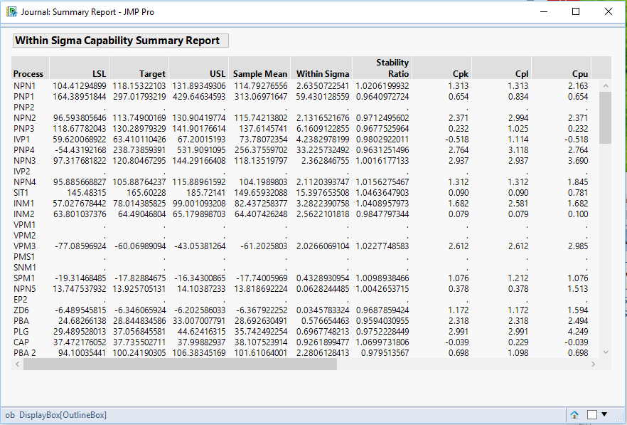

Try this script, it produces the following output
Here is the script

Re: Table summary for out of spec
Hi,
With few modifications it's work fine
Thanks for the fast and great support!
Assaf
Here is the script
Hi,
Assaf
