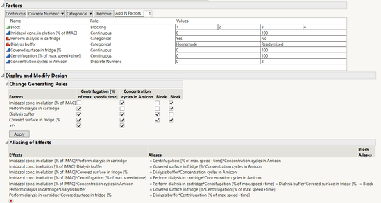

I am setting up a factorial screening design and want to adjust the 2FI aliasing so it fits my anticipated interactions.
What I would like is to have [Perform dialysis]x[Centrifugation % of max] aliased with [Imidazol]x[Covered surface area]
My problem is I cant get my head around the logic of the "Change Generating Rule" tab during design generation.
I read the help topic but I am still lost.
How do I interpret that weird table. Everything I do feels random and half of the time I do end up with a block effect aliased with a main effect.
cheers ben

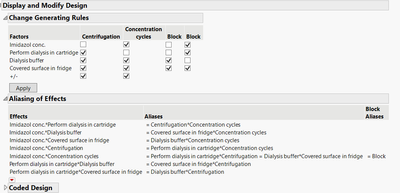

Hi @BenGengenbach,
I tried to generate a screening design with the aliase you specified.
If we "code" your factors (except block) with X1, X2, ..., that means you have this generator for the fractional factorial design : I = 1245.
However, the presence of the block is quite difficult to take into consideration, as we have to take care that it is not confounded with main effects or any other effects, which is a quite tricky task since the aliases are fixed here.
When trying to set up this generator in the generating rules, here is the configuration I have :
So here is an example of a design with the alias you defined (table attached):

Regarding the design set up: Did you enter the design generator deducted from my desired aliasing or did you modify it afterwards via the "generating rules" tab?
In case of the later it would be great if you could explain how to interpret it, as even @Mark_Bailey  noted that is table is quite tricky to understand.

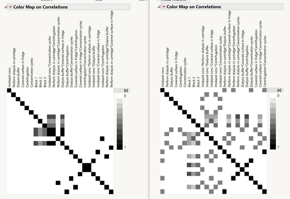

The rational behind this is simply that the aliasing is less harsh and more evenly distributed between multiple 2FI, correct?

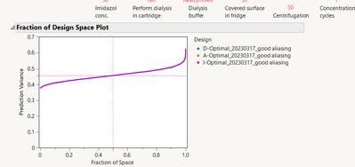

Left is the factorial right is the A-optimal:
And did you choose the A-optimality by default because I said screening?
Interestingly when generating the optimal designs with the same factors, aliasing and, seeds, but different optimality criteria FDS is absolutely identical.
Is this to be expected?
regards ben

I had to modify the "generating rules" tab in order to have the aliases you specified. This does take me some time to visualize the logic behind, and I'm (still) not 100% able to explain this logic, but as a general rule you have to check together the combinations you want to aliase, and avoid having the same pattern in different columns (to avoid aliasing main effects with block, or main effects with interactions). Each time you change a check, you can "apply" and visualize in the "Aliasing of Effects" panel if the aliases are correct depending on what you need or not.

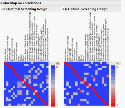

Correct, an optimal design will try to "dilute" the aliases in a more uniform way than traditional fractional factorial designs, where aliases are simply present or absent ("binary aliases").
Traditionally, the optimality criterion for screening designs is D-optimality, as it enables to have a good precision on the estimation of coefficients : Optimality Criteria (jmp.com)
  • D-optimality focuses on precise estimates of the effects.
  • A-optimality results in minimizing the average variance of the parameters estimates of the model.
  • I-optimality minimizes the average prediction variance over the design region, so it is better suited for Response Surface Models/predictive designs.
I would highly recommend to watch the presentation of Bradley Jones about modern screening designs, where he emphasizes on the advantages of A-optimal screening design vs. D-optimal screening design : 21st Century Screening Designs (2020-US-45MP-538) - JMP User Community
You can for example put different emphasis on the main effects you want to screen by specifying different weights, making A-optimal screening designs very flexible. As I didn't change the weights of the A-optimal design, the design is indeed very close from a D-optimal designs, except for correlations/aliases created in the designs :
And average correlations between designs :
