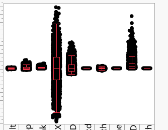

The names of my x-axis variables show up vertically aligned.
I would not want to use 'rotated tick options'. Because this increases the horizontal dimension of the chart in an undesired way.
Instead if I can swap the X and Y axis, then the input variable names will become reader-friendly, without increasing the size of the chart :)
Please refer the image. Sorry, I had to crop the image to avoid publishing company data on public platform.

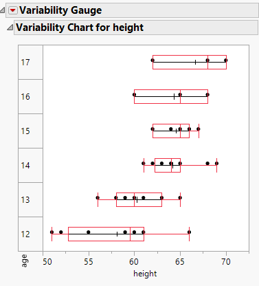

Hello,
I am not sure if this is what you're looking for or not, but you can select Vertical Charts within the Variability platform to swap the axes.
Thanks.
Laura

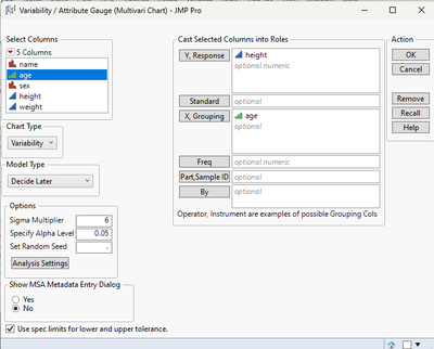

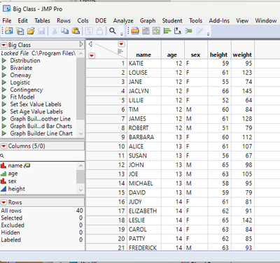

Open your data table.  In Laura's example she used the Big Class data table from the Sample Data Folder available under the Help pull down menu.
Go to
     Analyze=>Quality and Process=> Variability // Attribute Control Chart
In the dialog window that is displayed, select column height for the Y, Response and column age for the X, Grouping and click on OK.

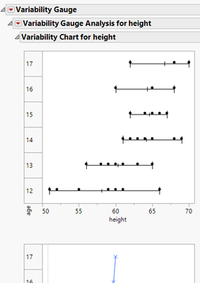

The Output Display window will appear
Click on the red triangle to the left of the title for the outline box titled "Variability Guage Analysis for height" and select "Vertical Charts"
The display will change to a Vertical form
