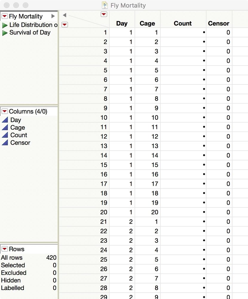

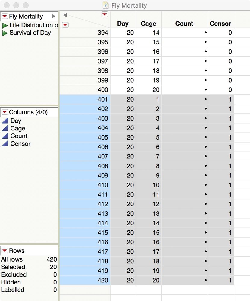

I think that there are at least three ways to analyze the mortality in JMP: Life Distribution, Survival, and Probit (using GLM in Fit Model). Let's start with the first two. You data is fine but it should be organized like this:
You have 20 cages running for 20 days. Enter the number of new dead flies in the Count column for a given day and cage. Enter the number of surviving flies at the end of the table, in the rows with Censor = 1:
Then use the two saved table scripts to start the analyses.
I attached this template data table for you so you have to do is enter the Count data.

Re: Survival Statistics: Cage mortality
