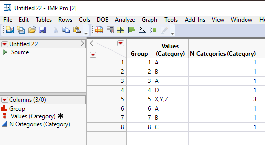

I think the way to start is to do a split on the data table, and then to work from there.  Below is a simple script that I wrote to get you the results you want.  If your need is to do this interactively, just follow the steps in the scriptsplit.PNG
Names Default To Here( 1 );
// Create the beginning table
dt = New Table( "Example",
	Add Rows( 11 ),
	New Column( "Group",
		Numeric,
		"Continuous",
		Format( "Best", 12 ),
		Set Values( [1, 1, 2, 3, 4, 5, 5, 5, 6, 7, 8] )
	New Column( "Category",
		Character,
		"Nominal",
		Set Values( {"A", "A", "B", "A", "D", "X", "Y", "Z", "A", "B", "C"} )
// Change the group column to character so
// split columns are blanks and not missing values
dt:Group << data type( character );
// Split the columns
dtSplit = dt << Split( Split By( :Category ), Split( :Group ), Group( :Group ), Sort by Column Property );
// Change the data type back
dt:Group << data type( numeric );
dtSplit:Group << data type( numeric );
// Convert all of the non blank entries to the value of the column name
For( i = 2, i <= N Cols( dtSplit ), i++,
	theRows = dtSplit << get rows where( As Column( dtsplit, i ) != "" );
	If( N Rows( theRows ) > 0,
		Column( dtSplit, i )[theRows] = Column( dtsplit, i ) << get name
// get all of the character column names
namesList = dtSplit << get column names( character, string );
// Create the combined column
dtSplit << Combine Columns(
	delimiter( "," ),
	Columns( :a, :b, :c, :d, :X, :y, :z ),
	Column Name( "Values (Category)" )
// Count the number of combined values
dtSplit << New Column( "N Categories (Category)",
	Numeric,
	"Continuous",
	Formula(
		count = 1;
		While( Word( count, :Name( "Values (Category)" ), "," ) != "", count++ );
		count = count - 1;
// get rid of the formula
dtSplit:Name("N Categories (Category)") << delete property(formula);
// delete the unnecessary columns
dtSplit << delete columns( namesList );
Jim

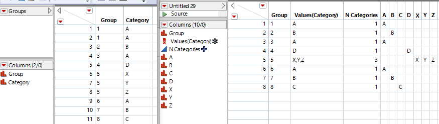

Re: Summary of categorical levels
I see now Jim has already presented a solution.
Here's a different approach using Tabulate and Combine Columns (Multiple Response Column) that hopefully works also on the full data set.
// Groups is the example table with 2 nominal columns
DT_GroupCategory = Data Table( "Groups" );
// creates a cross table
Tab_DT_GroupCategory = DT_GroupCategory << Tabulate(
	Add Table(
		Column Table( Grouping Columns( :Category ) ),
		Row Table( Grouping Columns( :Group ) )
// make data table from it
DT_GroupCategory_CrossTab = Tab_DT_GroupCategory << Make Into Data Table;
DT_GroupCategory_CrossTab << Add Multiple Columns( "N Categories", 1, after( 1 ), Numeric );
Names_DT_GroupCategory_CrossTab = DT_GroupCategory_CrossTab << Get Column Names;
// replace 0 by missing and everything else by column name (probably not the most efficient way to do this)
For( i=3, i<=N Items( Names_DT_GroupCategory_CrossTab ), i++,
	Column( DT_GroupCategory_CrossTab, i ) << Data Type( "Character" );
	For( j=1, j<=N Rows( DT_GroupCategory_CrossTab ), j++,
		If( Column( DT_GroupCategory_CrossTab, i )[j] == "0",
			Column( DT_GroupCategory_CrossTab, i )[j] = "",
			Column( DT_GroupCategory_CrossTab, i )[j] = Char( Names_DT_GroupCategory_CrossTab[i] );
// make multiple response column with Cols -> Utilities -> Combine Columns
DT_GroupCategory_CrossTab << Combine Columns(
	delimiter( "," ),
	Columns( 2::N Items( Names_DT_GroupCategory_CrossTab ) ),
	Selected Columns are Indicator Columns( 0 ),
	Column Name( "Values(Category)" )
// add formula to get N Categories. +1 is added for one less comma, then div by 2 to get number of categories
Column( DT_GroupCategory_CrossTab, "N Categories" ) << Formula( (Length( :Name( "Values(Category)" ) ) + 1) / 2 );
Tab_DT_GroupCategory << Close Window;

	keys = tmpaa << Get Keys();
	// if the category_col is numeric, need to convert the numbers to chars!
	If( Is Number( keys[1] ),
		charkeys = {};
		For( ki = 1, ki <= N Items( keys ), ki++,
			charkeys[ki] = Char( keys[ki] );
		charkeys = keys
	);	// stuff all the items together and dump it into this row
	valstr = Concat Items( charkeys, "," );
	Column( dt_sum, sum_colname )[ri] = valstr;
