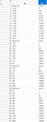

Hi,
I have a table that contains several data set as shown below. How can I save those level 0, level 1, level 2... to different data tables with jsl?

Basically you just need to use the Split platform
     Tables==>Split
However, before that you need to create a new column called Level and use the formula to create new values that represent the levels.
Here is the formula, based upon your data
If (Row()==1, theLevel=0);
If(left(:bits,5)=="Level" then theLevel++);
theLevel;
Once this new column is created, then go to the
     Tables==Split
and Specify
     Level as the Split By Clumn
     Vt and Bits as the Split Columns
You will need to do a bit of clean up, getting rid of the rows that have Raw Curve and Level as values, and you will need to change the columns from character to numeric.
