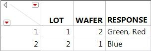

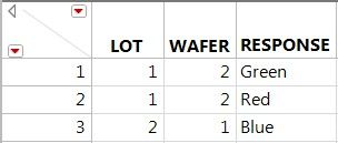

I have a table of lots and wafers, which have been assigned a response code based on yield (red, green, blue; not my choice, but it's what I have to work with). There are combinations of lots and wafers that have multiple responses assigned to them. What I want to do is summarize the table by lot and wafer, and where a combination has multiple repsonses add all values to the variable.
From:
To:

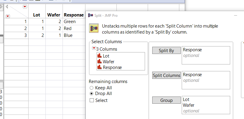

Perhaps you were looking for a scripted solution, in which case, you can stop reading... @ian_jmp 's works perfectly. However, if you want to do this interactively, the following should work for you:
1. Use Tables->Split (place Response in the Split By and Split Columns roles and Lot, Wafer in the Group By role):

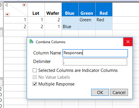

2. In the new table, select the new columns and then use the Cols->Utilities->Combine Columns menu to create the new, multiple response column:
3. Press delete to do away with the select columns.
Hope this helps.

That did it, though I still need to try Ian's script. I used Tabulate and Recode to accomplish the first step you did with stack, but I ended up with the same result for step two, which I hadn't used before. Again, thanks for the help.
