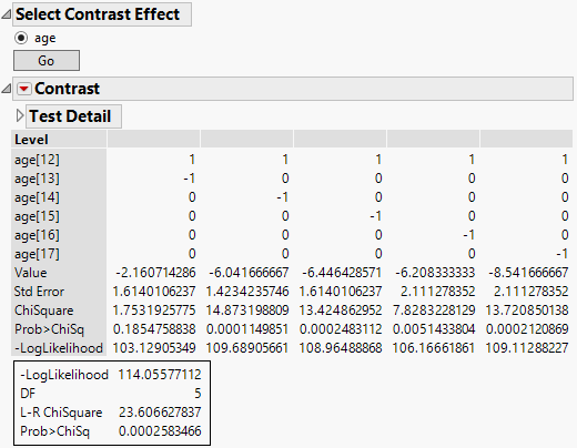

The contrast report is not difficult to understand and use. I illustrate it here using the sample data set Big Class and a GLM using the normal distribution and identity link function. I tested height against age. Then I specified a series of comparisons between age=12 and all the other ages separately. The result is:
The bottom of the report is the place to start. The likelihood ratio test (L-R ChiSquare) is for any significant contrast. This statistic is your control of type I errors with multiple comparisons. The result here is significant at alpha=0.05 so we conclude that at least one contrast is significant. The individual contrasts show that the mean height for age=12 is not significantly different from that of age=13 but it is significant for the other ages.
