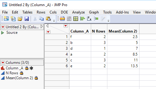

txnelson
Re: Summarize Without Alphabetizing
If the order you want to summarize by is the order found in the data, you can set the column property, "Row Order Level" for Column_A, and then run
     Tables==>Summary
and the data will be summarized in the order the grouping column was found in the data table
Jim

dale_lehman
Level VII
Another reason I'm glad I rarely script anything - Tabulate works just fine with Value Ordering.

txnelson
I have tried setting the Value Ordering column property for both numeric and character columns under JMP 14.3 and the Summarize() function uses the Value Ordering property as it's order.
