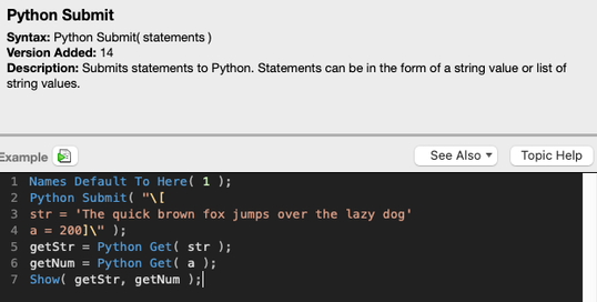

Re: Stop python code being written to JMP log
The scripting index shows the optional parameter echo(True | False).
Python Submit( code, echo(False) );
Unfortunately, this optional argument is ignored in 18.0 ( and 18.0.1 ) so the log capture is the way to go at this point.

matth1
Level IV
The echo parameter doesn't appear in the scripting index for me, in either 18.0.1 or 17.2:
Is it in Pro only?
It may have been documented in the on-line help documentation or it was an unintentional oversight.  It also may have been mentioned with Python Execute().  If you run across documentation of the optional arguments echo(True | False) you will probably also see another optional parameter expand ( True | False ).  Disregard that one, it's been removed in 19.
