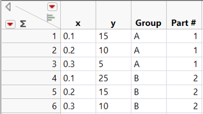

I know we need to format the data table in JMP, I did the following data table, but still cannot plot the scatter with lines and markers. , could anyone advise how can I do it in JMP? Thanks.

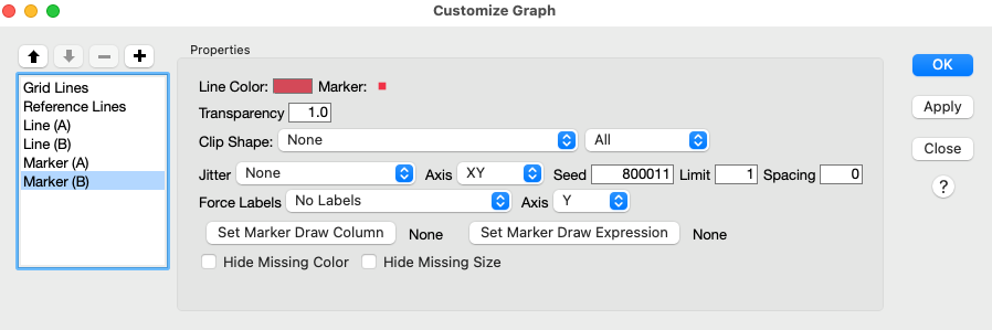

Hi @TDK_Long
Right-Click on the graph and click customize to change the maker shape.
Graph Builder CustomizeGraph Builder CustomizeGraph Builder Change Marker ShapeGraph Builder Change Marker Shape

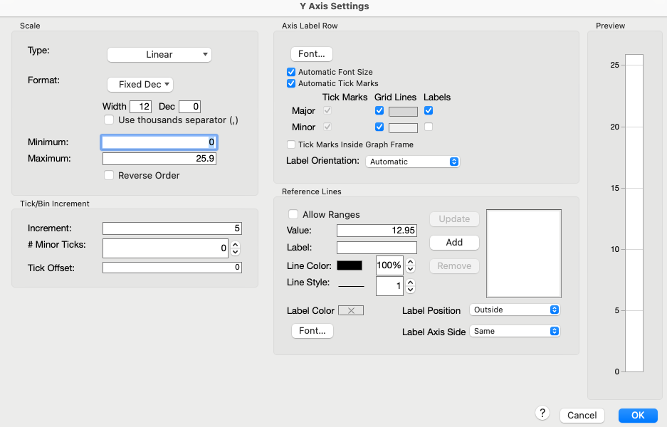

Right-Click on the axis to add grid lines
Axis Settings Add Grid LinesAxis Settings Add Grid Lines

Hi @TDK_Long

TDK_Long
Level III
Re: How to make a plot of scatter with lines and markers like Excel?
Hi Stan,
I have a problem at the first step. How do you create the two lines? I cannot connect the three points as shown below. Could you use the attached jmp file to see what I am missing? Thank you.

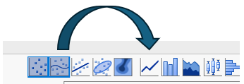

Drag Group onto the Overlay dropzone. That's it.
[x on x, y on y]:)
If you want to connect the lines instead of a smoother, just switch from smoother to "Line":
