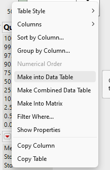

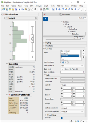

I assume you mean Distribution platform and this table box
You can edit them from Properties
You can right click on the table and select Show Properties
Or use Properties from the toolbar and then click on the table to edit it

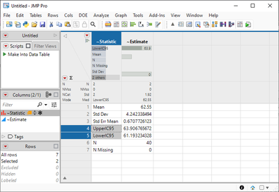

You could also it into a data table and update them there
