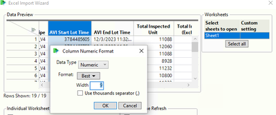

Hi @BHarris ,
During import, you can right click the column to define is as nominal. But, I guess you want to automate that without the need to re-defined it again every time you open the working file.
I think if you can convert the script to an "add-in", it is possible to tell JMP that if they see a column with specific name, always define it as nominal whenever you open the file.
