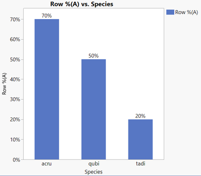

Re: Stacked bar - show % contribution of each column (using Graph builder)
The problem is that without the Dead group, there is no way to know what the percentage is unless you calculate it beforehand. Think about it with your picture. You cannot possibly know the percentage alive unless you also know the percentage dead. So, if you want JMP to calculate it automatically, get a bar for the Dead also. If you are okay with doing some of the calculations, then you will need to create a column with the percentage that you want.
This is partially why I chose the Mosaic plot. It automatically "stacks" the alive and dead bars so it mimics a traditional bar chart, but no calculations are necessary.
But, here is how you can do it. Note that there are multiple ways to do this, I am choosing one that will not require you write any formulas. I will also be ignoring the Sampling Period since you did in your graph, and using the sample table I included in an earlier post.
Choose Analyze > Tabulate.
Drag Alive/Dead to the Drop zone for columns.
Drag Species into the Drop zone for rows (the label will disappear, but remember the location. It will be the left-most box of the table).
You should see this:
Now in the field with all of the statistics listed, drag Row % and drop into the middle of the table. Your table should now look like this:
From the red triangle menu at the top-left, choose Make Into Data Table.
You now have a data table with this information.
Go to Graph Builder.
Drag Species to the X-axis.
Drag Row %(A) to the Y-axis.
Change the graphing element to a bar chart.
I then changed the label to be Label by Value.
And click Done.
Lots could be done to make this prettier, but you have the basics.

I recognize that without having both alive and dead the percent total can't be calculated I was just hoping there was some way to force graph builder to do it without modifying my table by adding calculations (as a new user, seemed way to difficult). I did use tabulate to calculate the percents but didn't consider going the step further and making a graph from that - I will!
