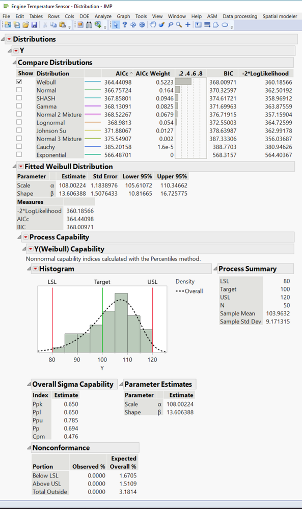

How to make script for Process Capability analysis with certain distribusion dynamically?
Atatched code and result are what I want to do with JSL on JMP 15, however this is hard-coded unfortunately. This does not work for other data with different distribution.
I want to know the way how to make the Process Capability analysis dynamically with best distribution in the followings:
  1. Y » Continuous Fit » Fit All
  2. Choose Top distribution (In this case, 'Top' is 'Weibull')
  3. Fitted 'Top' Distribution » Process Capability with spec limit (I am interested in Ppk value)
dt = Open( "$SAMPLE_DATA/Quality Control/Engine Temperature Sensor.jmp" );
lsl = 80;
target = 100;
usl = 120;
obj = dt << Distribution(
	Continuous Distribution(
		Column( :Y ),
		Quantiles( 0 ),
		Summary Statistics( 0 ),
		Histogram( 0 ),
		Vertical( 0 ),
		Outlier Box Plot( 0 ),
		Fit Normal( Show Fit( 0 ) ),
		Fit Cauchy( Show Fit( 0 ) ),
		Fit Lognormal( Show Fit( 0 ) ),
		Fit Exponential( Show Fit( 0 ) ),
		Fit Gamma( Show Fit( 0 ) ),
		Fit Johnson( Show Fit( 0 ) ),
		Fit SHASH( Show Fit( 0 ) ),
		Fit Normal 2 Mixture( Show Fit( 0 ) ),
		Fit Normal 3 Mixture( Show Fit( 0 ) ),
		Fit Weibull( Process Capability( LSL( lsl ), Target( target ), USL( usl ) ) )

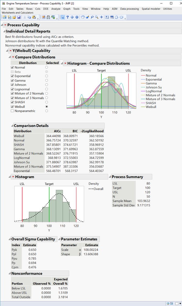

Depending on your JSL experience you might find it easier to script the Process Capability platform (under Quality and Process) rather than the Distribution platform.  It has a 'best fit' option:
dt = open("$SAMPLE_DATA/Semiconductor Capability.jmp");
dt << Process Capability(
	Process Variables( :INM1 &Dist(Best Fit) ),
	Individual Detail Reports(1),
	Capability Index Plot( 0 ),
	Goal Plot( 0 ),
-Dave

Thank you very much for usuful information. This is what I wanted to do.
lsl = 80;
target = 100;
usl = 120;
obj = dt << Process Capability(
	Process Variables( :Y & Dist( Best Fit ) ),
	Spec Limits( :Y( LSL( lsl ), Target( target ), USL( usl ) ) ),
	Individual Detail Reports( 1 ),
	Capability Box Plots( 1 ),
	Goal Plot( 0 ),
	Process Performance Plot( 0 ),
