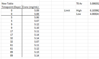

I have an analysis problem I'd like some advice on. Below is a table of some real stability data- from which I'm trying to extract a reasonable stability prediction.

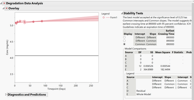

I usually use the degradation profiler for this, and have done up until now without any issue for multiple other projects - but this dataset is causing me a headache; I believe it's because we had an anomalously low T0 which skewed the trend making the predictions….. Optimistic.
Table Linked - with the associated acceptance limits we have.

2-We know therefore, that it is impossible for this material to gain activity. i.e. the upward trend is due to assay noise.
3-We also know from previous data and experiments that this material degrades in a roughly linear fashion, and expiry's (i.e. when the confidence levels cross the lower limit) in the region of 730-1095 days are not unusual.
My question therefore is how to analyse this. I'd be comfortable using something like a wider confidence interval and expanding that out as the prediction but wouldn't know how to do that.
The next data collection point is in 3 months, so while I'm comfortable that the 'real' trend will emerge over time and the early assay noise will be averaged out I need to make some sort of realistic prediction now. Any suggestions/guidance (despite telling-off the scientist who did the T0 :) ) would be great!

4. These data could be "fit for purpose"; there is no evidence of a trend. So, given the data (mean = 5.11, SD=0.028),a 95% lower prediction interval bound for one rep is 5.055 (using distribution platform). That gives you a margin of 5.055 - spec = 5.055 - 4.1 =  0.995 mg/mL. So, it would have to drop nearly 1 mg/mL over the shelf-life to be at risk. Is this kind of drop consistent with other batches?
