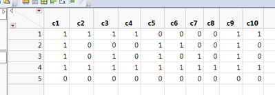

Hi! I want to parse a string of characters. I have 202 binary bits in my string and I want to cut that string in half. I believe I could find the length of the string and maybe get it to return the values at a certain number of characters. I'm just not sure how to actually use that to cut it in half and have two columns with 101 bits in each. And after I get that, I want to separate every bit into it's own column. So I want 101 columns of either a '1' or a '0' in it. I just don't know how to parse it by number of characters.
Thanks for any help!!

Try this
// input data is a string of character 1s and 0s representing bits
string = "11110000111000110010";
// split the string in two at the middle
// this substring starts at character 1 and goes for half the length
firsthalf = Substr( string, 1, Length( string ) / 2 );
// this substring starts just beyond the previous and the
// implicit length goes to the end
secondhalf = Substr( string, 1 + Length( string ) / 2 );
// the 1 and 0 bits go one per column
ncols = Length( firsthalf );
// start a fresh table
dt = New Table( "example" );
// add columns wtih names like "c3" for each bit
For( i = 1, i <= ncols, i++, // the || operator joins two strings
  dt << New Column( "c" || Char( i ) ) // i is a number, char makes a string
// make a helper function to add bits to a row in dt
adddata = Function( {bits}, // parameter to function
  {i, c}, // local variables
  dt << addrows( 1 ); // function knows to use dt
  For( i = 1, i <= Length( bits ), i++,
  c = Column( dt, "c" || Char( i ) ); // same as above
  dt:c = Num( Substr( bits, i, 1 ) ); // put bit in column
// each call to adddata puts a row of bits in dt
adddata( firsthalf );
adddata( secondhalf );
adddata( "1010101010" );
adddata( "1111111111" );
adddata( "0000000000" );
Craige

Thank you! That helped a lot. Unfortunately that was just the beginning of what I wanted to do, and I'm not sure how to do that rest...
So I really need to indicate what half of the string I'm looking at. All 100 rows of strings I am splitting are for the same data, and all the first half strings have the same name, and so do the second half strings. And once I have that I need to graph both halves separately. When I tried to graph it manually in JMP, it did not turn out as I expected. How I have done this analysis is through Excel because it displayed the graph how I wanted it to be. Basically I just need all the new columns that the bits go into (in this case they are voltages) along the x-axis and the data along the y-axis
The only problem is that I couldn't figure out how to do that in JMP. Any help?

Generally there is a dependency between the way your data is organised and what a JMP platform will (or won't) give you.
I'm not sure I've understood what you are after completely, but if you add this code to Craige's above I think you will get close:
dt2 = dt << Transpose(
columns( :c1, :c2, :c3, :c4, :c5, :c6, :c7, :c8, :c9, :c10 ),
Output Table( "Transpose of example" )
dt2 << Graph Builder(
Show Control Panel( 0 ),
Variables(
X( :Label ),
Y( :Row 1 ),
Y( :Row 2 ),
Y( :Row 3 ),
Y( :Row 4 ),
Y( :Row 5 )
Elements( Position( 1, 1 ), Bar( X, Y, Legend( 12 ) ) ),
Elements( Position( 1, 2 ), Bar( X, Y, Legend( 13 ) ) ),
Elements( Position( 1, 3 ), Bar( X, Y, Legend( 15 ) ) ),
Elements( Position( 1, 4 ), Bar( X, Y, Legend( 23 ) ) ),
Elements( Position( 1, 5 ), Bar( X, Y, Legend( 27 ) ) )
You would have to adjust the values in column 'Label' to be the voltages, and you could do that with 'Recode' or through a little more JSL. Once you have what you want, it may be that there is a more direct way to get there.
