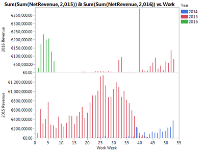

Re: Date Functions Converting DMY to DM (filtering everyday by Today() function without year)
You could do DayofYear() or WeekofYear() plus a Year() column.  It won't give you an exact date but it will be comparable (Day of year may be off with leap years).

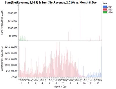

Or even just break it out with a column for each day, month and year.
I might be missing what you're trying to do though.
