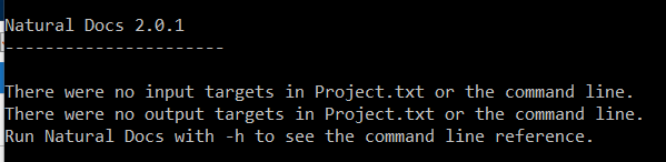

       I tried to take cue and install Natural Docs. After setting it up the way detailed here (http://www.naturaldocs.org/getting_started/getting_set_up/#starting_a_new_project) , when I try to run configure to generate documentation , I get the follow ing
However, as instructed , I did provide the input folder and output folder - Any thoughts on what I did wrong ?

@uday_guntupalli I'm going ahead and installing it on a new computer.  I'm happy to document and share the procedure once it's complete it(I had to extend the configuration to handle the JSL language).

I've just installed on a new PC - attached is a description of the process
