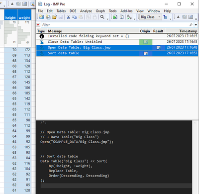

As you want to sort both in same direction, perform the action interactively and get the script from enhanced log
// Open Data Table: Big Class.jmp
// → Data Table("Big Class")
Open("$SAMPLE_DATA/Big Class.jmp");
// Sort data table
Data Table("Big Class") << Sort(
	By(:height, :weight),
	Replace Table,
	Order(Descending, Descending)
Most likely it is using default sorting for the second column which seems to be ascending
// Sort data table
	Replace Table,
