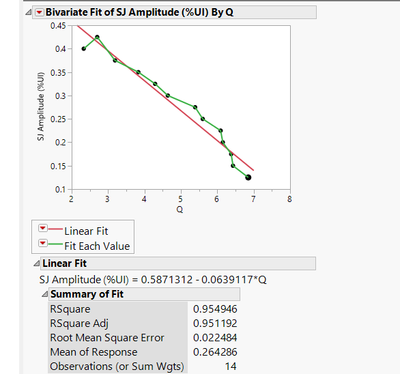

Hi,
JMP has constitute the linear regression formula. In this case Q is the slope. I wanted to see the Q=7 and Q=8 demonstrated in the line plot about. How do I do that in jmp. Otherwise I need to calculate and put in excel or data table,

Create a new column by saving the prediction formula. Then in the Q column enter desired values for Q and the values for the prediction will populate in the data table.

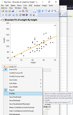

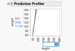

If you have JMP17 you might be able to launch profiler from red triangle next to Linear Fit
-Jarmo
-Jarmo
